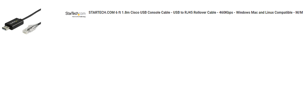

No, because I do not have a console cable, and if I had, I do not have a serial port anymore. Unless there is a console cable out there with an USB port on it.
Hello @PCBarnes ,
You need to use console cable for checking what happens on backplane. Because of that if you have opportunity to get usb console cable, you sould buy it.
If you create a case to fortinet support, they will ask that.
Do you think this could do the job?

Hello @PCBarnes ,
Actually i don't know it will work or not. But i have this type of usb console cable.It works without any problem. You can read review and description your suggestion. If someone said its compatible with networking devices, i think its okay you can use it.
Ok, I think I'll buy that one :) Thank you!

I was able to run the backup restore from the new serial cable. All is well now.
