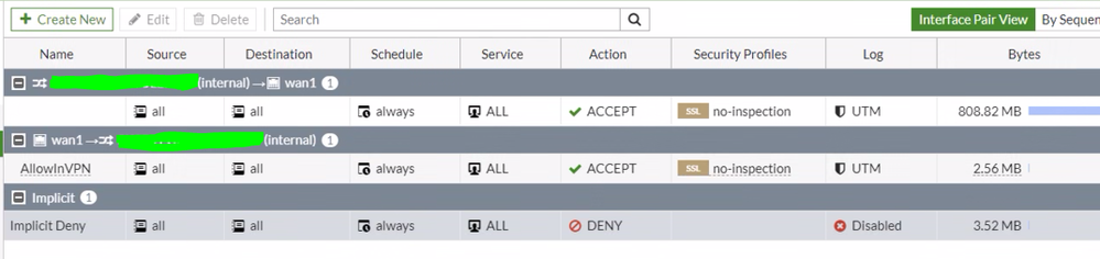

I am setting up a firewall FG-60F in transparent mode and this is my config :
Internet <-> LTE Router <-> Firewall <-> Local Switch1
Upstream the firewall there is an LTE router, dowstream the firewall there is a network switch 1. I have the firewall configured in transparent mode with management IP 10.10.10.1 and the LTE router is 10.10.10.250. When I connect locally to the network, I can ping all the devices on my network and also I have internet.
The problem is when I connect via the VPN.
The VPN setup is as follows, the router has an OpenVPN tunnel to an external server, and I connect to this VPN server via an OpenVPN client. When I am on the VPN, I get assigned IP on the network 11.36.255.13, and at this point I can ping the firewall on 11.36.3.1 and the router on 11.36.3.250, but I cannot ping anything downstream the firewall (switch1 and other devices). If I remove the firewall from my network and I connect to via VPN, I can ping the switch1 on Ip 11.36.3.10 (locally it is 10.10.10.10).
Regarding firewall policies, I have only one allow-all policy, and regarding static routes I have one route for outgoing traffic and the second route is to try to get the VPN traffic to downstream devices.
As it is right now I cannot ping downstream devices, any idea what I am doing wrong?
firewall policy
static routes
Solved! Go to Solution.
I was missing a policy to allow traffic from wan1 to Internal, now it works.
