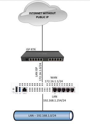

Ok ede. but in this case what ip i must use like remote gateway on forticlient. below overview of my design i use one ip of lan isp like gateway on my fortigate
No way, sorry. I imagined that you have a Fortigate externally. Just a FC will not do.
If you have access to the ISP router, you could port forward something onto the FGT WAN port. But if you don't I don't see any way to achieve this.

In your case, you would need to set up something on your ISP router (where the actual internet breakout is) to forward connections to a specific port/IP/hostname through to FortiGate, but you mentioned this is not an option, correct?
If you have a different VPN server (with a public IP), FortiGate could initiate a connection to it (as a spoke, essentially), and you could reach FortiGate through that other VPN server.
But:
- either, you must make FortiGate reachable from internet somehow (DDNS, port forwarding)
- or FortiGate must establish a connection to a different VPN gateway to which you can also connect, and reach FortiGate through that
