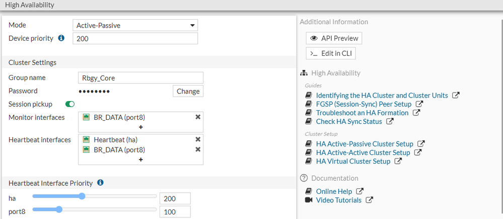

I have a 2 400E box that are configured as an active/passive cluster.
Recently we are seeing in the HA log a lot of lost heartbeat errors.
As per redundancy we quick at another heartbeat interface to the Ha configuration
We are still receiving error message. (see screen shots .

Hi @jomof ,
My understanding is that you are experiencing those missing heartbeat message randomly and the 2 units are directly connected by a cable. You have already attempted the below steps:
- replace the HA cable with a brand new one and issue is still there
- add a second port to the HA config setting and the messages are still there.
I can see that the error is not very frequent, usually when there is a hardware fault those messages are more frequent based on my experience. Did you notice if the message is seen when there is a particular peak in traffic?

Hi @jomof ,
Is this HA directly connected or they are going through a switch etc?
You may refer here how to troubleshoot the HA heartbeat packet lost:
Hello @Ramu
Is this HA directly connected or they are going through a switch etc? They are connected directly.
Regards
Can you run "get system performance status" to see if there is any specific cores with high CPU usage? You may also check the CPU graphs for last 24 hours to see if there were any CPU spikes matching with heartbeat messages.
Can you also check the heartbeat interval?

Hi @jomof ,
Has the traffic increased in the past weeks?
In addition to what my colleague Suraj suggested, please check/monitor the number of sessions especially while the packet lost message is seen.
get sys performance status
get sys performance firewall statistics
diag sys session stat
If you should notice a too high amount of session when the messages are seen, you may try to implement a delay in session synchronization:
config system ha
set session-pickup-delay enable
or dedicate a second port just to the session sync ("set session-sync-dev portX").
The article below might help:
https://docs.fortinet.com/document/fortigate/6.0.0/handbook/495912/improving-session-sync-performanc...
Best regards,
