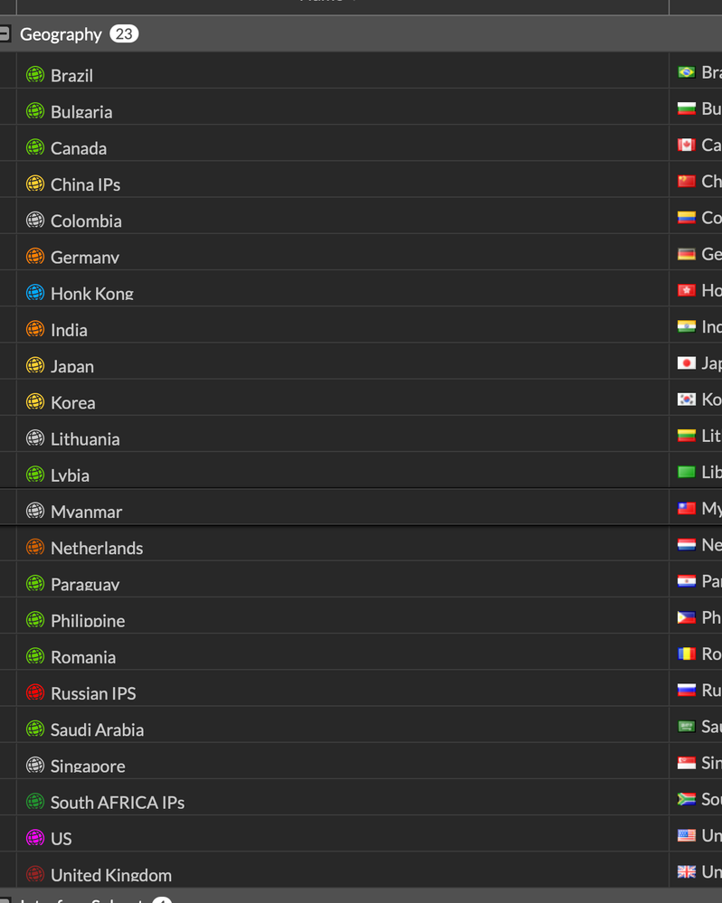

What I am doing at present is to create geographical policies in Adresses (on per each of the countries bothering me):
and then I add them one by one in a Firewall Policy with destination to specific IPs where I have the DB and the service as destination:
