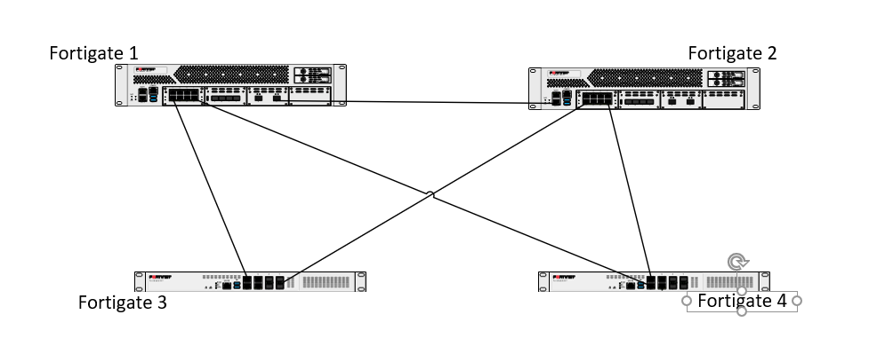

Do I need to configure/enable ECMP for OSPF or does it work by default? I know that it needs to be enabled for BGP.
I have the below scenario with OSPF between all 4 firewalls.
Currently using statics for 3 to get to 4 and 4 to 3, as there are 2 equal cost paths.
If I remove the statics will the Fortigates be load balancing over the 2 paths or do I need to enable something on ECMP or OSPF? I was worried about asymmetric routing.
If you're concerning about routes between FGT3 and FGT4, at least path1: 3-2-4 and path2:3-1-2-4 have different total costs. So both sides use path1 to take the shortest path. And it's automatic by OSFP protocol.

Toshi_Esumi thank you for your reply.
For router 3 path 3-1-4 equals path 3-2-4 and
for router 4, 4-1-3 and 4-2-3 are equal, so they will appear in the routing table. Currently using statics with link monitor, but I do not like statics and would be nice to load balance.

There is no "different ECMP modes". But need to enable RFC1583 compatibility.
https://community.fortinet.com/t5/FortiGate/Technical-Tip-OSPFv2-ECMP-for-External-Routes-Expected-B...
Toshi
Above was for external routes. Then if you were talking about the load balancing algorithms, this is the setting.
https://community.fortinet.com/t5/FortiGate/Technical-Tip-ECMP-Load-balancing-algorithms-for-IPv4-an...
Toshi
