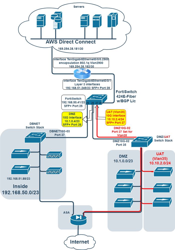

We have a working Cisco router doing bgp to AWS Direct Connect. What is the correct way to create the layer 3 interfaces (Direct-Connect, inside and dmz/uat) and the required Vlan 2900 with correct dot1Q encapsulation. Do I create on a sub interface like with Cisco? See Cisco settings below. See attached drawing.
I am assuming just plugging in existing HPE switch to interface assigned on FortiSwitch for "DMZ/UAT" and for "Inside" but how do I create the interfaces correctly on FortiSwitch? IP's should be assigned to layer 3 but "router" does not give the options I think I should see.

Here are FortiSwitch settings I have applied or compiled so far:
AWS-DC-Megaport # show system interface
name Name.
internal static 192.168.50.41 255.255.254.0 up physical
mgmt dhcp 0.0.0.0 0.0.0.0 up physical
uat static 10.10.2.4 255.255.255.0 up vlan
How do I configure DMZ/UAT to use same interface (diff vlan) on fortiswitch?

UPDATED DRAWING!!!!!
Created on 05-06-2024 02:29 PM Edited on 05-06-2024 03:55 PM
OK, went thru a bunch of example scenarios and been testing all day. Used examples from Cisco Forums, Fortinet Forums and even with ChatGPT for the FortiSwitch BGP and have decided to keep the Cisco because it works with BGP. Now we connected the FortiSwitch to it on it's "Lan" side. So now I need to know how to trunk a Cisco 10G interface to a FortiSwitch. We decided to keep the FortiSwitch in the picture because we can separate vlans out to 10G interfaces.
So port 28 to Cisco, it should carry all vlans we define (1,1?,35). I reset the FortiSwitch back to factory and set just an IP and hostname and I can now reach it and the ASR thru it.
Now I need to get these two other vlans to talk to the switch but here's the issue.
This is a separate switch stack
"Inside" or Lan Database network (DBNET) = Native Vlan1
It has other vlans but we do not need them at the moment
These is ALSO a separate switch stack
DMZ network = ALSO Native Vlan1
UAT network = Vlan 35
If I assigned a unused Vlan to the fortiswitch port that is connected to the DMZ switch stack, wouldn't it pass the traffic?
Thanks for looking and all your time on this.

Latest drawing with Cisco re-included. Those in yellow are NOT working
