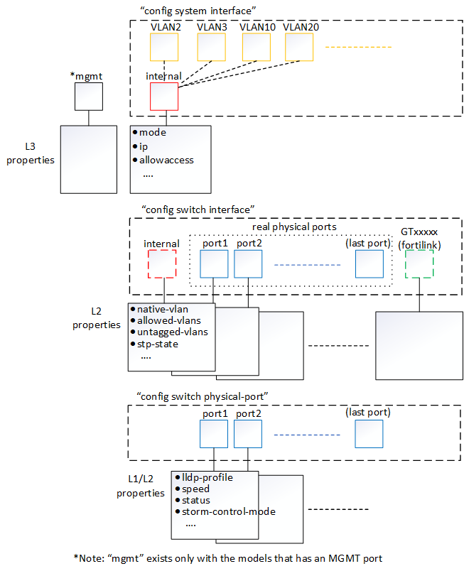

OK, I did this (from the docs) and have a RVI
Create a system interface. Set the IP address and netmask, set the interface type to physical, and then assign the layer-2 interface.
config system interface
edit <new_interface_name>
set ip <IP_address_and_netmask>
set type physical
set l2-interface <existing_interface_name>
Does this look correct?

Does anyone know default encapsulation mode on FortiSwitch interfaces?
I need 802.1q
I think .1Q only. That's why you can't find the command to select the encapsulation.
Toshi
And you're setting it up as "standalone" with L3 features that require licenses, which I've never done myself, so I can't comment on them specifically. But I can tell the concept of L2/L3 configuration mainly viewed from L2 side and up.
You already figured out L3 interfaces need to be configured under "config system interface". But probably never imagined those L3 VLAN interfaces have to be sub-interfaces of "internal" special L3 interface if you haven't dealt with any FortiGates before.
Then to connect L2 VLANs at physical ports to those L3 VLAN interfaces, you have to include those VLANs as allowed-vlans on the L2 special interface "internal" under "config switch interface". It might be hard to understand but I depicted this command line structure in below.
But beyond this, especially L3 features like BGP, you'll soon realize you likely need to refer to FortiGate(FGT) documentation since those features must have been "imported/ported" from FGT's software.
And you likely need to open a ticket at TAC to get help or figure them out by yourself by referring to FGT's documentation. I had to figure out above almost all by myself recently to utilize FSWs as L2 switches. But in my case, I have some experiences with FGTs.
Toshi
Thank You for the detailed explanation. It is extremely valuable. Can I send you the config I came up with? I am able to ping from a host on my "inside" network all IP's listed in my drawing except the AWS-DC interface (only because I have not moved the cable from the Cisco to the FS. I want to see if you believe I have setup the interfaces correct based on what you outlined above.
Sure. I'll take a look at it when I have time to do so.
Toshi
