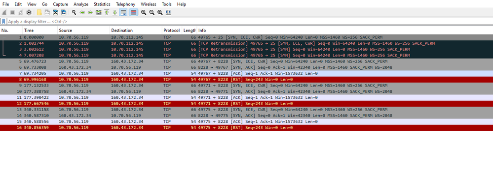

Thanks. I've captured the packet below for reference.
Who causes the RST from the packet below? source or destination?
Thanks
10.70.56.119, is sending the RST (source). Also, the connection is reset before any certificate exchange, so the issue may not be related to certificate. Can you confirm from which interface this capture is taken? The interface between Fortigate and Internet or Fortigate and LAN? You may take similar capture from Internal interface and external interface to confirm the behavior.
That one is the closest to the destination, after that its the Bloomberg router at the prem (colocated).
I have a packet capture closest to the source as well
As per this capture there is a Client Hello, as expected. but this packet is missing in the first capture (mostly getting dropped by a firewall/proxy). Can you take a pcap on the Fortigate internal interface, if the Client hello is coming to Fortigate , then Fortigate is dropping it and we need to run additional debugs.
