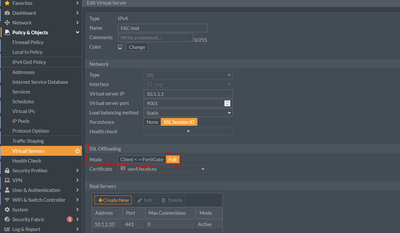

Most probably the cameras are running older version of HTTP/S that are deprecated and not supported by the modern browsers (usually SSL instead of TLS).
You can configure Virtual servers in FGT with Full SSL offloading and maybe point out to http port of the camera.

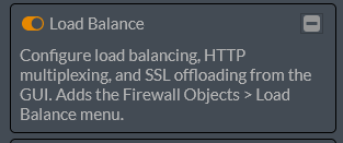

Hello @ebilcari,
I do not see the Virtual Servers tab on my FortiGate. Do you know what feature visibility I need to enable to see that option?
The feature is under Load Balance
This feature offers also LB capabilities for more than one server and I think here is easier to configure than on SSL/Inspection.
