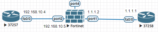

I have tested this in my lab, but if I configure vip only than dnat works but traffic wont move inside to outside, only outside to inside works, i created a snat from inside to out and now both translations work.
config firewall central-snat-map
set srcintf "port2"
set dstintf "port1"
set orig-addr "obj-192.168.10.4"
set dst-addr "all"
set nat-ippool "78.5.6.7"
config firewall vip
set extip 78.5.6.7
set mappedip "192.168.10.4"
set extintf "any"
my policy
