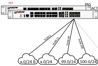

Attached representative physical diagram.
Attached representative logic diagram; 1 Trunk for 5 vlans with a gw each.

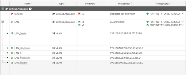

| FGTAE_HA1 # show system interface LAN config system interface edit "LAN" set vdom "root" set allowaccess ping https http set type aggregate set member "x1" "x2" set device-identification enable set lldp-transmission enable set monitor-bandwidth enable set role lan set snmp-index 39 next end  |
FGTAE_HA1 # show system interface x1 FGTAE_HA1 # show system interface x2  |

Vlan interfaces on FortiGate 'LAN' interface is the gateway for the vlans? Ping is from which source to which destination? Could you post the output of #diag netlink aggregate name LAN from *both* FortiGates?

LAN is the trunk that contains the gw of each vlan.

"diagnose netlink aggregate name LAN" the second is a passive slave
FGTAE_HA1 # diagnose netlink aggregate name LAN status: up member: x1 member: x2
