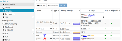

Is the management interface using native VLAN (what you ping) or passing as a tagged? What if you check the MAC addresses from one switch to the other, do they get propagated?
The Management interface is using the data vlan id and is also going across the link aggregation port to the Cisco switch. I just noticed from looking at your screenshot that I have nothing configured under the port trunks settings, should I?

This is an example, port2 is connected a host that is part of VLAN 532 and port1 as the uplink (Cisco trunk):

Port #1 is my desktop and port 44 is the uplink to the Cisco Switch
Is it possible you have native LAN mis-match?
I see, usually another VLAN is used as access for the end hosts (port 1). In this case I suppose you have to use VLAN 15,16 or 501. It doesn't have to be the native VLAN.
If not created yet you also need to create the VLANs (15,16,501) on FSW from GUI:
Switch> VLAN [+ Add VLAN]
As I remember Cisco is very strict on trunk building. You have already used the same native VLAN (995) on both nodes, I suppose it will expect also to allow the same VLAN on both sides.
