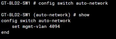

2. After a factory reset of the REMOTE switch, the mgmt-vlan is set to 1 vice 4094. It needs to be set to 4094. The problem is, as soon as I set it to 4094, I lose direct access to the switch. I do not have physical access to the switch. I have a helper on site who connected a spare laptop to the switch on port 1. I remote into that spare laptop to configure the switch. As soon as I set mgmt-vlan 4094, I lose access. I cannot ssh back in using ssh admin@192.168.1.99. Does the IP change? The only option I have is to have my helper do a factory reset, which changes the mgmt-vlan back to 1. Fortinet Support says that has to be 4094. Can I simply change the mgmt-vlan to 1 for all devices?

Unfortunately, there is a bug in the FortiAP-432FR device firmware which does not allow mesh mode to work at all. We actually installed UniFi p2p devices and were able to get the fortiswitches working over the wireless bridge with this info. We also had to enable the mgmt vlan on the the fortiswitch to get the gate to recognize it. Should look like the following.
config
