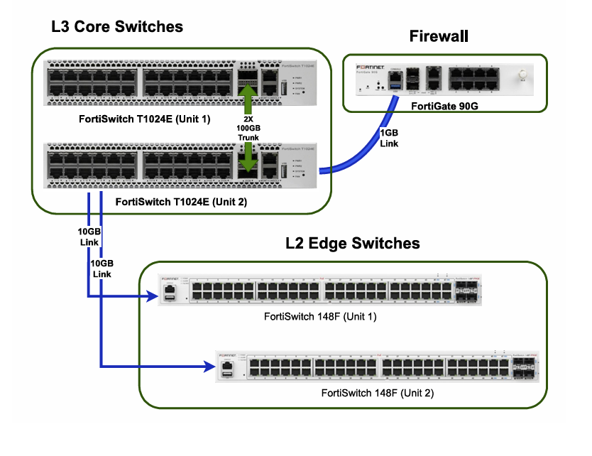

I have a FortiGate 90G firewall and two FortiSwitch T1024E switches. I want to create a hybrid configuration where the FortiSwitch T1024E switches handle all internal VLAN routing.
I want to avoid all traffic flowing through the FortiGate, as this would create a critical performance bottleneck in my system.
The main questions are:
1) can the pair of FortiSwitch T1024E's handle all internal Layer 3 routing between VLAN's?
2) do I need special licensing features for Layer 3 functionality?
3) if I attach FortiAP access points to my system (at the Layer 2 Edge switching level), how are these managed? Via the FortiiGate firewall? Or via the L3 switching stack?
Please suggest any critical configuration settings to enable inter-VLAN routing by the T1024E's while maintaining as much management integration as possible across Fortinet devices.
FSW T1024E can do routing but it needs extra license.
Here is a link for reference :)
Configuring VLANs | FortiSwitch 7.6.3 | Fortinet Document Library
