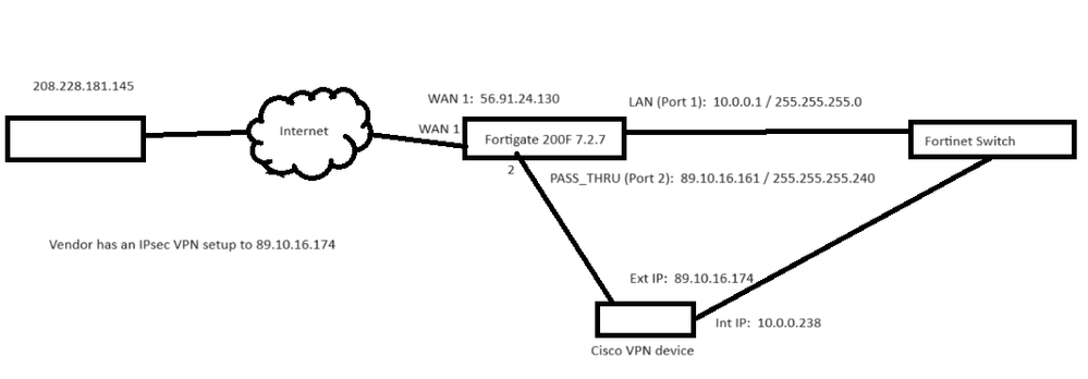

I have a situation where we are trying to allow a vendor to VPN into their device on our network, which is physically connected to our firewall. See the diagram attached. We've tried to create firewall policies to allow WAN 1 > Port 2 and Port 2 > WAN 1, but we're not seeing any traffic hitting those rules. They are at the top of the policy list to make sure nothing interferes.  Fortigate is on OS 7.2.7
The vendor is initiating the VPN from 208.228.181.145
The WAN 1 interface to our Fortigate is 56.91.24.130 /30
Port 2 on the Fortigate is configured with a public IP of 89.10.16.161 / 255.225.255.240
The device they are trying to reach we've given a public IP of 89.10.16.161

I think it's already open. At least I could ping 89.10.16.174 from my end (in the U.S.).
Since it's public IP on their device routed through your FGT without NAT, no VIP is needed.

Since it has a separate public IP, you can allow "ALL" services to the device IP. It's a Cisco VPN device, which should have own access-control mechanism to block other unauthorized access like my pinging.
Just sniff on the interface:port2 after disabling auto-asic-offload on those policies.
