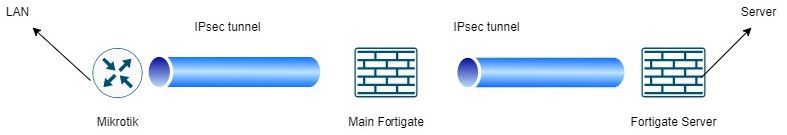

I drew something to be more understandable.
Basically, I would like from the Mikrotik LAN, access to the servers connected at the "Fortigate Server", passing through the "Fortigate Main" IPsec tunnel.
I don´t know if it's possible, that's why I am asking if you know about it?
I tried in the "Main Fortigate" to accept traffic between the IPsec tunnel Mikrotik and the IPsec tunnel Fortigate Servers in both directions.
In the "Fortigate Server", I added the Mikrotik subnet in both rules " IPsec Main Fortigate" -> "Lan Servers" and "Lan Servers" -> "IPsec Main Fortigate"
I put the route in the "Fortigate Server" toward the Subnet Mikrotik through the tunnel.
I put the firewall rule in the Mikrotik toward the "Fortigate Server" subnet.

This is possible. There's no reason for it not to work assuming things are configured properly.
You just need to figure out what the issue is that's blocking it. Without more info we can't really help you though.
Do you have routes configured properly on all devices?
Do your IPSec tunnels allow the encryption/decryption of traffic from all subnets involved in the traffic flows?
Do you have firewall policies allowing all traffic everywhere in the chain?
What do your traceroutes look like?
What do your IPSec debug logs look like?
Etc. etc. etc.

It is possible. Here are a few things you can check are configured properly:
I am assuming that your tunnel from mikrotik to Main fortigate and from Main Fortigate to Fortigate server is working fine and that your issue is for passing traffic between Mikrotik to Fortigate server and vice versa.
IP Sec Phase 2 selector:
On edge fortigates: Make sure the Fortigate server is added as remote subnet on Mikrotik and local subnet is selected as the Mikrtotik lan that you want to have access.
Same thing on the Fortigate server side. Make sure you have Fortigate server subnet as local and Mikrtik lan is remote subnet
On Main Fortigate: Make sure you add phase 2 selectors with Mikrotik as local and Fortigate server as remote and also with Fortigate server as remote and Mikrotik as local subnet.
Firewall polcies:
You have to add 2 Firewall policies on all these fortigates: Ip sec tunnel ---> local subnet. Local subnet -----> IP Sec tunnel.
Make sure you allow the relevant subnets to pass in the firewall policy.
Static Route:
You will also need static routes for the relevant subnets out the IP sec tunnel.
Here is an IP Sec troubleshooting document you can refer to for troubleshooting:
https://community.fortinet.com/t5/FortiGate/Troubleshooting-Tip-Troubleshooting-IPsec-Site-to-Site-T...
If you run into any issues, let me know.
Cheers,
Varun

The Mikrotik is configured in full remote browsing until the Main Fortigate, then even if I create a second tunnel toward the Fortigate Server, I cannot access to the servers if I don´t disable the Remote Browsing tunnel. I can understand why, but I think that's why I need to passing through both IPsec tunnel, or maybe you have another solution?
EDIT: F**k, as soon as I changed the order of the tunnel in my Mikrotik, everything worked well.. I can understand the importance of the order of tunnels now !
Many thanks !
