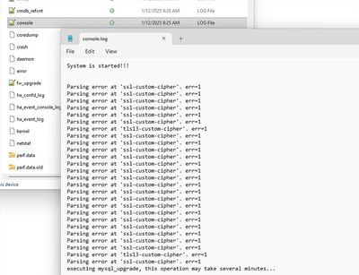

Example of the error output: The FortiWeb console connection displays error messages as shown in the image below after upgrading the FortiWeb firmware version to v7.6.6.
Sample Image:
Export the system debug file from the FortiWeb management pane and extract the system debug file. Open the console.log file, which shows the output from the console display.
Identify the error messages: FortiWeb parses the full config and reloads it into the system after the firmware upgrades and reboots. A parsing error would mean that FortiWeb failed to parse the specific config line after upgrading the firmware version. To identify the error, scan and check through the CMDB log files to look for the parsing error lines.
