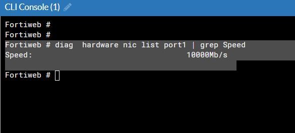

Interface Speed is the estimate of current Bandwidth that the interface can support. It is calculated or denoted in bits per second.
There can be a requirement to check the speed of the interface/port in case there is a Speed mismatch between the connecting devices.
To check the Speed of the particular interface of the FortiWeb, the below command can be used. In this example, speed is checked for Port1.
Fortiweb # diag hardware nic list port1 | grep Speed
Note: Make sure to use the spelling as it is mentioned above. |
