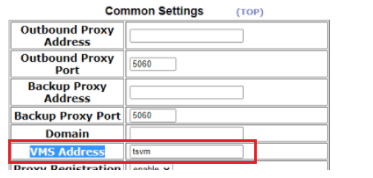

This article describes what to do if the Voice Mail button is missing from the FortiFone.
FortiFone.
  1. Login to the FortiFone using the browser.
  2. Navigate to the VoIP settings page or Account page.
  3. Look for the setting 'VMS Address' or 'Voice Mail'.
Or:
  1. Fill in the value 'tsvm'.
  2. Reboot the FortiFone.
