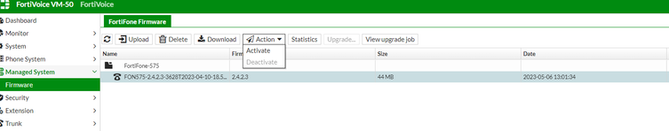

Go to Managed System -> Firmware and select the specific Fortifone firmware.
Select Action -> Activate.

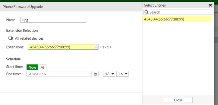

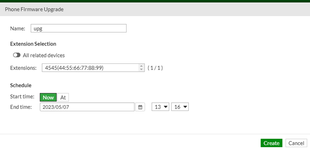

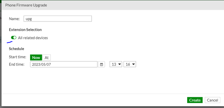

Uncheck All related devices.
Select the specific extension to upgrade.
Choose the start time and create.
