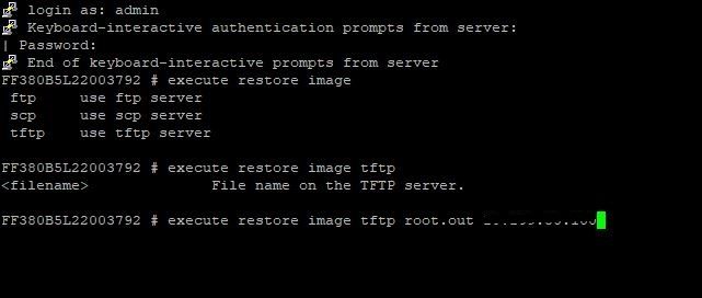

  • Install the TFTP tool with TFTP32.
  • Log into the phone using SSH (ex. admin/23646 in case default settings).
  • Use the following command to upgrade a firewall on the phone:
FF380xxx # execute restore image tftp FW_file TFTP_SERVER_IP
Replace FW_file with the real firmware file name and TFTP_SERVER_IP with the TFTP server IP address.
