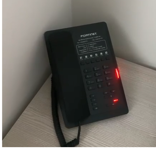

Description This article describes how to stop the blink of the red light in FortiFone-H25.
Scope FortiVoice 6.4.x, FortiFone H25
Fortifone H-25 may not stop to blink even when there is no call:
After Fortifone H-25 version 2.4.1.5500, the user has the option to stop blinking by going from GUI in Phone Settings -> Features, and under 'Power Led Settings', disable every line.
