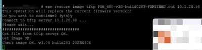

  4. Run the following CLI command in the SSH client:
execute restore image tftp <FW_image_name> <TFTP_IP_address>
     5. The output below indicated that the FortiFone managed to get the firmware image from the TFTP server and upgrade it.
     6. Check the FortiFone and it should be upgraded successfully.
