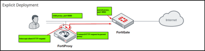

Example setup, FortiProxy (child-proxy) intercepts incoming HTTP requests from the user. It then forwards the HTTP request to FortiGate (parent-proxy).
Computer IP@: 10.100.3.119

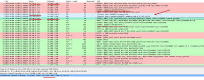

FortiProxy will perform a DNS lookup on a client request. Refer to the packet capture screenshot below:

With the Server URL configuration, the FortiProxy will not perform the DNS lookup on the URL that matches the Server URL setting. Refer to the packet capture screenshot below: |
