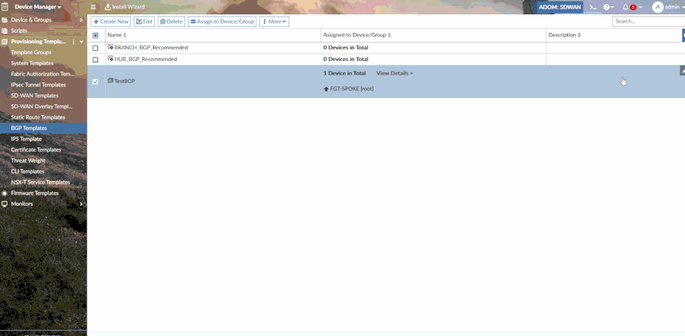

This error is related to BGP configurations specifically on 'config router prefix-list' where when checking on the FortiGate itself, the error is explained in more detail.
FGT-SPOKE (IN) # show
    edit "IN"
        config rule
                set prefix 10.119.0.0 255.255.0.0
                set ge 17
                set le 17
FGT-SPOKE (IN) # end
Invalid prefix range -- make sure: len < ge-value <= le-value object check operator error, -650, discard the setting
Command fail. Return code -650
This error mentioned 'ge' value must be greater than the prefix length and less than or equal to the 'le' value.
The combinations of 'ge' equal to 17 and 'le' equal to 19, will allow subnets 10.119.0.0/17, 10.119.0.0/18, and 10.119.0.0/19.
