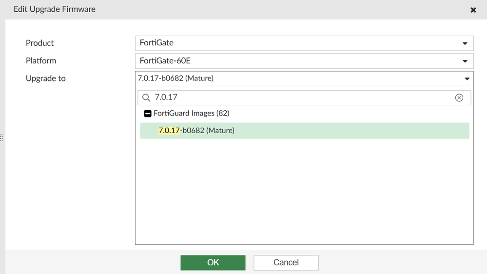

Navigate to Device Manager -> Firmware Templates -> Choose the template -> Edit. On the 'Upgrade to' section, ensure to choose the target version under 'FortiGuard Images', then select OK.
Then, scroll down to the bottom and make sure to enable the 'Let Device Download Firmware From FortiGuard' option. Then, proceed with the installation as usual.
