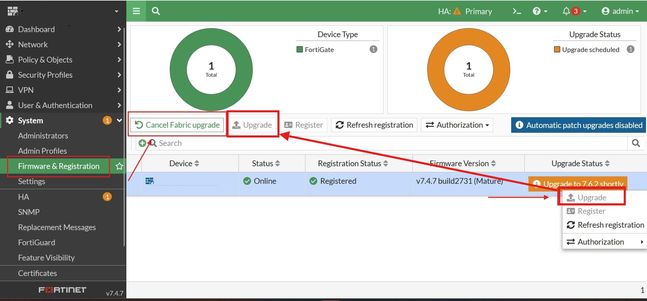

The Upgrade button under FortiGate -> System -> Firmware is grayed out in some cases, even when a new version of the firmware is available, preventing the upgrade process from proceeding. See the screenshot below:
This issue occurs when the firmware upgrade is triggered via Fabric Upgrade instead of the standard Upgrade option in the FortiGate GUI.
Note that:
execute federated-upgrade cancel
Once the Fabric Upgrade is canceled, the Upgrade option will become available, allowing the firmware upgrade to proceed as expected.
