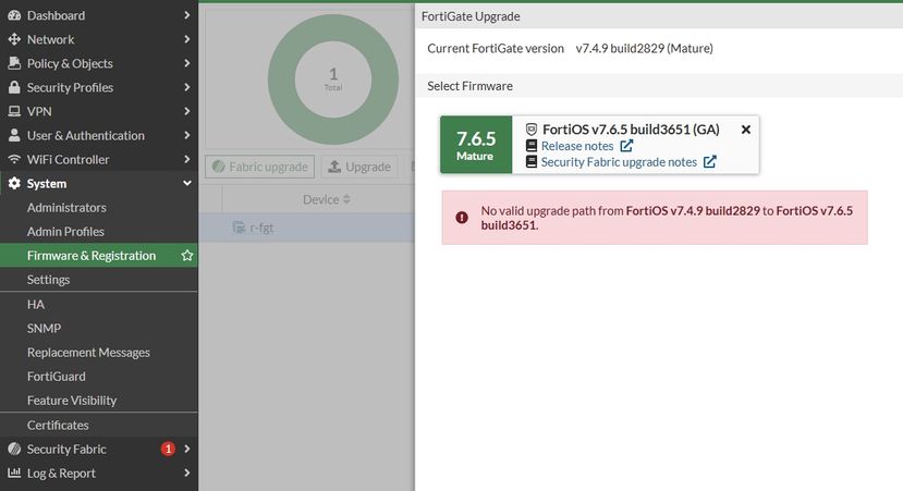

In affected firmware versions and platforms, the upgrade path matrix cannot be downloaded as it is too large for the assigned buffer. This causes supported upgrades to incorrectly show no valid upgrade path.
Example upgrading FortiOS v7.4.8 to FortiOS v7.4.9:
Attempting to upgrade a VM from FortiOS v7.4.8 to v7.4.9 shows the following error in the GUI: 'No valid upgrade path from FortiOS v7.4.8 build2795 to FortiOS v7.4.9 build2829'.
However, the upgrade path from v7.4.8 to v7.4.9 is supported for this platform. The same applies to upgrading from v7.4.9 to v7.6.5.
