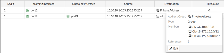

This happens because the destination address on Policy Route is the 'ALL' address. It will steer Internet traffic and all internal traffic as well, because it is being matched.
To resolve this, there needs to be another policy on top to stop Policy Route for internal traffic:
FGT-VM (root) # sh router policy
config router policy
        set input-device "port2"
        set src "10.10.10.1/255.255.255.255"
        set dstaddr "Private Address"
        set action deny
            set dstaddr "all"
            set gateway 192.168.30.1
            set output-device "port3"
FGT-VM (root) # sh firewall addrgrp Private\ Address
config firewall addrgrp
    edit "Private Address"
        set member "ClassA-10.0.0.0/8" "ClassB-172.16.0.0/12" "ClassC-192.168.0.0/16"
