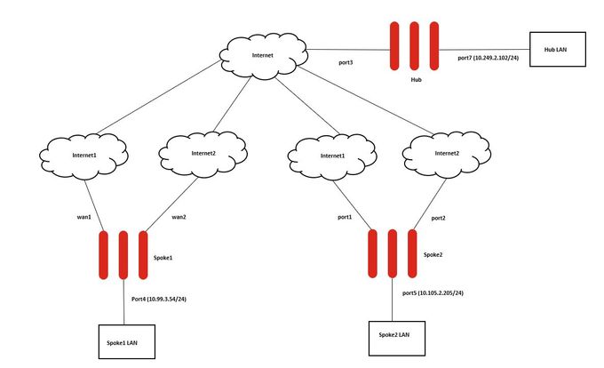

The setup is a Dial-up IPsec VPN Hub and Spoke. Both are in SD-WAN and use static routes.
The Hub has only one VPN tunnel that connects to multiple spokes that have multiple VPN tunnels each going to the same LAN network.
When using Performance SLA, the Hub ICMP reply is forwarded to the wrong Spokes VPN tunnel, which is asymmetric.
