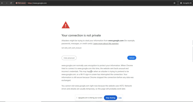

Description This article describes how to fix the certificate warnings 'ERR_CERT_DATE_INVALID' noticed after upgrading to FortiOS v7.6.3 for web-browsing sessions with deep inspection enabled.
Scope FortiGate v7.6.3.
Users may notice certificate warnings for deep-inspected sessions after the FortiOS firmware upgrade to v7.6.3. This is due to the re-signed server certificate provided by FortiGate having expired and not been renewed automatically.
This issue relates to the certificate manager feature change introduced in v7.6.3. The new option 'resigned-short-lived-certificate' feature is not working properly with certificate cache-timeout.
From v7.6.3, the resigned server certificate will be valid for 3 days after the date when it is resigned. The validation period is shortened to 3 days (4 days if the re-signing day is included) on purpose for security concerns.
