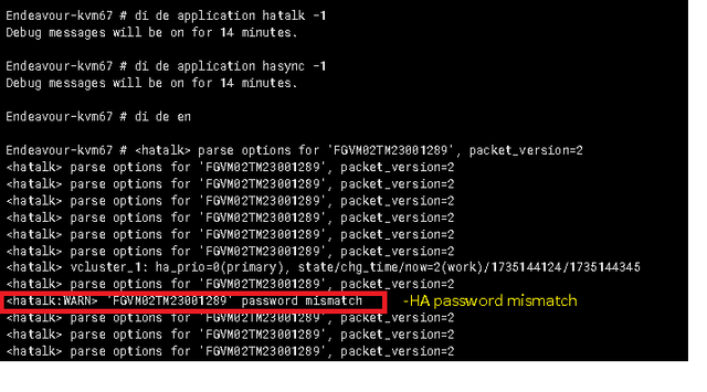

Run the following command to verify why FortiGate is not joining the HA cluster.
diagnose debug application hatalk -1 diagnose debug application hasync -1 diagnose debug console timestamp enable diagnose debug enable One of the possible reasons FortiGate does not join the HA cluster is due to an HA password mismatch.
set password “ ha_password ” After entering the correct password, FortiGate will join the HA cluster. |
