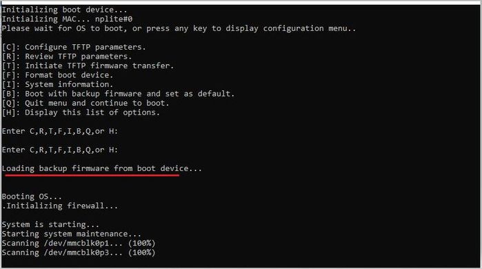

Option 1.
Use the 'Boot with backup firmware and set as default' BIOS option. For this option, make sure the customer has the backup configuration. Otherwise, try the option 2 first.
Power down the FortiGate and interrupt the booting sequence while it is booting up. Follow the steps below.
Note: Isolate the unit if it is in the HA cluster.
The FortiGate screen will look similar to this:
Zeroing IRQ settings...Done.
Verifying PIRQ tables...Done.
Boot up, boot device capacity: 28626MB.
Press any key to display configuration menu... <- Interrupt the booting here before it reaches the 'Found AV engine signature invalid' stage.
The following menu will appear after pressing any key:
[C]: Configure TFTP parameters.
[R]: Review TFTP parameters.
[T]: Initiate TFTP firmware transfer.
[F]: Format boot device.
[I]: System information.
[B]: Boot with backup firmware and set as default.
[Q]: Quit menu and continue to boot.
[H]: Display this list of options.
Enter C,R,T,F,I,B,Q,or H: <- Press B to boot with backup firmware.
Loading backup firmware from boot device...
Booting OS...
.Initializing firewall...
System is starting...
Starting system maintenance...
Scanning /dev/mmcblk0p1... (100%)
Scanning /dev/mmcblk0p3... (100%)
If this option did not help, attempt option 2.
