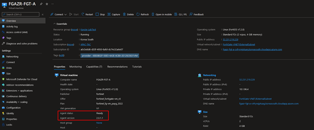

FortiGate deployed in Azure is equipped with a Microsoft Azure Linux Agent during installation. Occasionally, the Microsoft Azure portal states that the virtual machine agent is not ready and requests troubleshooting the issue:
When this issue occurs, it usually indicates a problem with connecting to the Azure Fabric Controller (168.63.129.16). Confirm this is the case with the following steps:

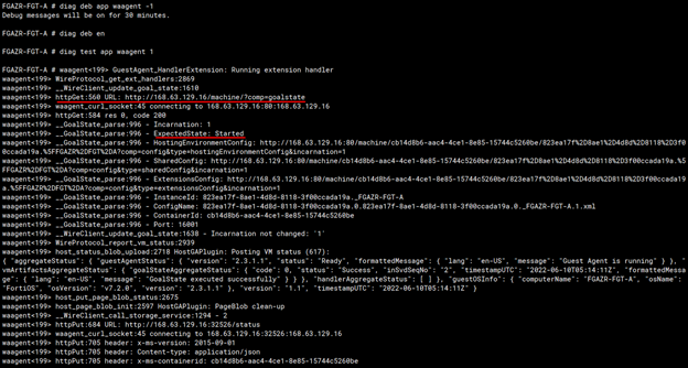

diag deb app waagent -1 diag deb console timestamp enable diag deb en diag test app waagent 1
Note that the virtual agent is trying to connect to Azure Fabric Controller IP 168.63.129.16 and the connection did not manage to go through.

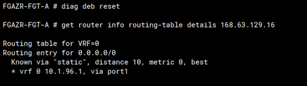

get router info routing-table details 168.63.129.16
Note that there is a static route configured to route traffic destined to 168.63.129.16/32 to port2.
config router static
What will happen in this situation is that the waagent will use the internal port2 as mentioned before, and since we need the static route for ILB probing we cannot delete the route for port2.

Waagent debug.
2024-07-10 15:06:56 waagent<15963> httpGet:560 URL: http://168.63.129.16/machine/?comp=goalstate <-- Communication with agent stopped.
