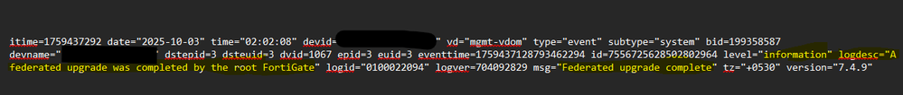

  1. Check the system event logs to identify the cause of the reboot. Go to Log & Report -> System Events -> General System Events.
  1. Verify that the auto-firmware upgrade feature is disabled. Go to System -> Firmware -> Auto-Firmware Upgrade and ensure that the feature is disabled.
  2. Check the federated upgrade settings. Go to System -> Federated Upgrade and verify that the upgrade is not scheduled. To confirm if an upgrade was invoked by a Federated Upgrade, refer to Technical Tip: How to confirm an upgrade was done by federated-upgrade feature.

Note: Even after disabling the auto-firmware upgrade feature, the firewall can get auto-upgraded with a federated upgrade due to an existing scheduled federated upgrade. To avoid this schedule upgrade, cancel it manually.
