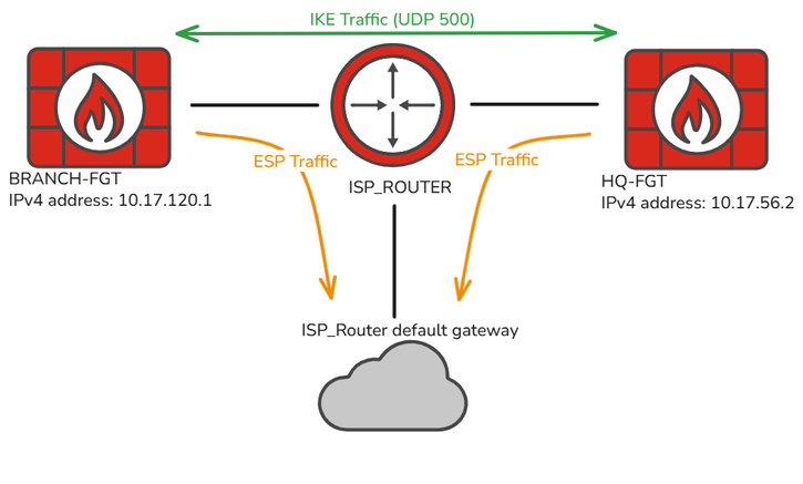

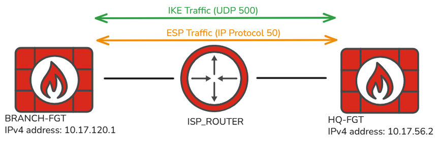

In the example deployment below, IKE traffic and ESP traffic typically take the same path between the two VPN gateways, allowing tunnel data traffic to pass between the sites.
During a link flap, IKE traffic and ESP traffic is briefly misdirected to an unintended gateway. IKE traffic recovers automatically after the interface flap, but constant data traffic may preserve an incorrect routing or forwarding decision indefinitely for session-less ESP traffic.

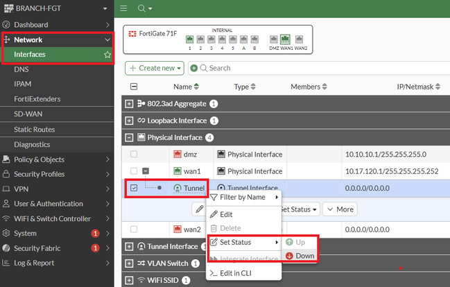

Disable the IPsec tunnel on both sides and wait for five (5) minutes. This is a common caching default value and allows the invalid routing/forwarding decision to time out on the ISP device(s).
GUI:
Go to Network -> Interfaces -> Expand physical interface dropdown -> 'Right-Click' VPN tunnel interface -> Select 'Set Status' -> Select 'Down'.

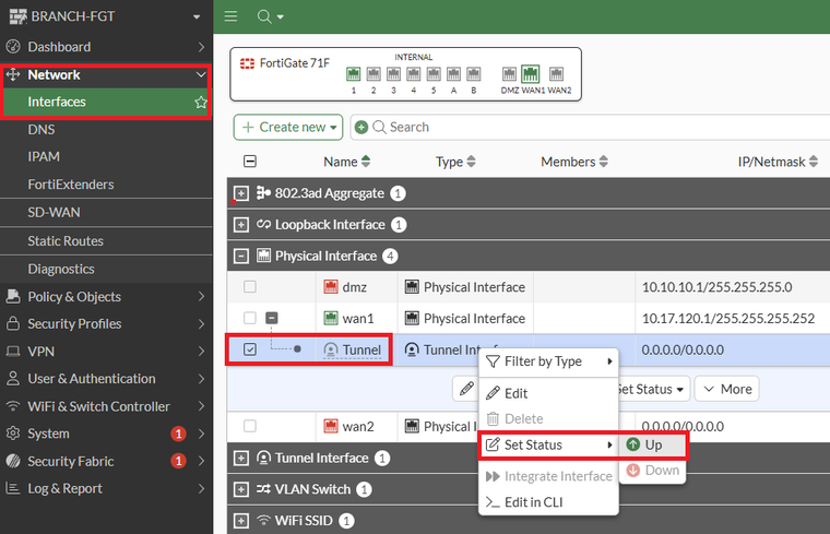

GUI:
Go to Network -> Interfaces -> Expand physical interface dropdown -> 'Right-Click' VPN tunnel interface -> Select 'Set Status' -> Select 'Up'.

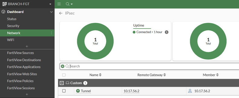

  • The tunnel shows 'Online' in the IPsec widget on both sides.
