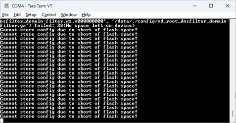

This article describes how to fix an issue where the error 'Cannot store config due to short of flash space!' is encountered when trying to implement Zero Touch Provision (ZTP) after joining FortiGate with FortiManager using a basic ZTP configuration.

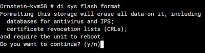

  1. If the shared partition indicated by the name EXDB-1.00000 appears to be full, try to format itwith the following command:
diagnose sys flash format
Be aware that formatting the shared partition will require a reboot of the firewall. It is highly recommended to do so during a maintenance window.
