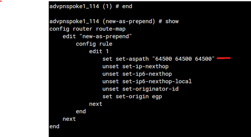

To check the results of the route map applied to the BGP configuration, issue the below commands:
get router info bgp route-map <route-map name>
route-map new-as-prepend is prepending the AS 64500 64500 64500 .
show router bgp shows the route map applied to the neighbor.
It is necessary to soft-clear the BGP session after applying or making changes route map against the BGP neighbor. execute router clear bgp ip < neighbor IP> soft [in|out]
get router info bgp route-map new-as-prepend shows the result of the route-map applied command.
