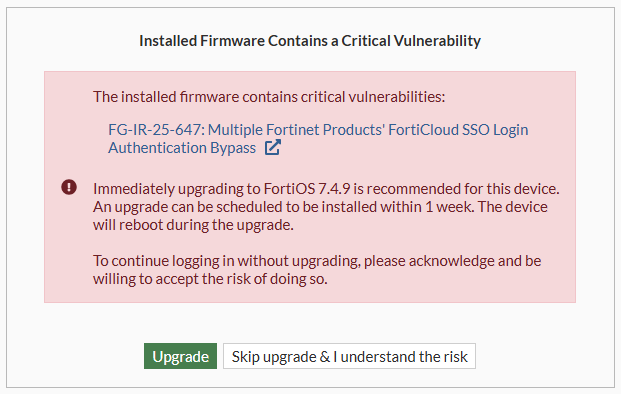

If a known critical vulnerability is detected, FortiOS displays an upgrade prompt after FortiGate login, accompanied by a GUI warning that allows the administrator to upgrade or skip, as shown in the image below. This notifies the administrator of potential security risks and enables immediate mitigation.

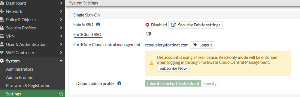

To mitigate exposure to this vulnerability in affected versions, the FortiCloud SSO login feature should be temporarily disabled until the device is upgraded to a non-affected version, such as v7.4.9.
To disable the feature, log in to FortiGate, navigate to Settings, and disable the 'FortiCloud SSO' option (it may also appear as 'Allow administrative login using FortiCloud SSO', depending on firmware).
Configure via CLI:
config system global
    set admin-forticloud-sso-login disable
This vulnerability affects only devices with FortiCloud SSO login enabled. Disabling the 'FortiCloud SSO' option mitigates risk until the device is upgraded to a fixed FortiOS version.

  • The vulnerable version check takes some time to perform and generally does not display immediately after boot.
  • The warning appears based on the firmware version. It will still display even if FortiCloud SSO login is successfully disabled.

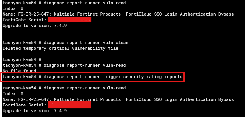

  • Although this does not mitigate the vulnerability, the upgrade warning can be temporarily cleared using the command 'diagnose report-runner vuln-clean'. See this document: One-time upgrade prompt when a critical vulnerability is detected upon login.
Once the Security Rating Report towards FortiGuard Servers is performed (every 4hours automatically), the banner will reappear as shown below:
