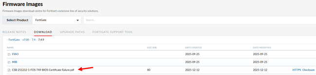

This is due to an issue with a BIOS Certificate Failure that happens specifically on the FortiGate 70G hardware and specific FortiGate firmware versions. Patched versions of FortiOS v7.4.9 and v7.6.4 have been released to FortiGuard. The Customer Support Bulletin for this issue is available in the FortiOS v7.4.9 download folder:

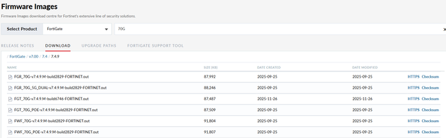

Upgrade to v7.4.9, which is available in FortiGuard or the Fortinet Support Portal.
To download the firmware from the Fortinet Support Portal, follow the steps below:
  1. Log in to the Fortinet Support Portal.
  2. Select 'Downloads' from the sidebar -> Select 'Firmware Images'.
Or:
Select 'Support' from the top -> Select 'Firmware Download' -> Select 'Product' -> Select 'Download'.
