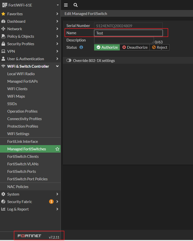

In version FortiOS (FortiGate) v7.2 and prior versions, it is possible to make the switch name changes by using the following CLI command:
config switch-controller managed-switch
    edit <switch-id>       <----- Usually this switch-id is the serial number.
        set name <NAME>
This can also be done the following way in the GUI:

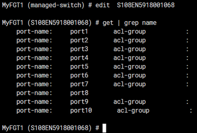

To add the FortiSwitch name, rename the managed FortiSwitch using the following CLI command on FortiGate:
    rename <switch-id> to <NAME>
Once renamed, it will show a warning that the managed switch will go offline momentarily.
Type 'y' and press enter.
After the change is made, the FortiGate GUI will reflect the change.
NoteRenaming the managed FortiSwitch from the CLI is deauthorizing the FortiSwitch in the background and thus causing the FortiSwitch to go offline. Therefore, this must also be done during a maintenance window to avoid any outages during production time.
