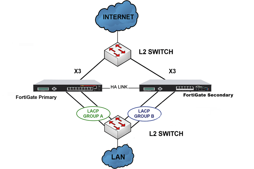

FortiGate units in an HA cluster using aggregate (LACP) interfaces on FortiOS 7.x and above.

The following proposal presents methods to improve and accelerate failure detection and failover in scenarios where LACP (802.3ad) and HA are in place.
  1. Enable Fail-Detect on Aggregate and Physical Interfaces: Enabling fail-detect ensures rapid failover when a critical link, physical or logical, fails. When an interface goes down, the fail-detect mechanism triggers the associated fail-alert interface to transition to a down state. Reaction time is approximately 2 seconds after an interface goes down and 1 second after it comes back up, as detailed in the Fortinet article:  Technical Tip: What is the reaction time of fail-detect. This feature is active only on the primary unit in a high availability (HA) cluster.  On the secondary unit, even if monitored interfaces go down, the corresponding fail-alert interfaces remain up.

In HA environments, this mechanism helps synchronize the failover process properly, avoiding asymmetric routing issues. The secondary unit will take full control of both LAN and Internet traffic until the primary unit recovers.

  1. In HA configurations, beyond adding the LACP interface, the individual member interfaces should also be configured. As discussed, LACP is a logical interface and has slower failure detection compared to physical interfaces.
config system ha
    set group-name "Test"
    set mode a-p
    set override disable
    set monitor "x1" "x2" "x3" "agg1"
