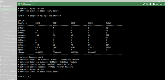

Below shows an expected result after the firmware upgrade.
To display NPU session statistics on FortiGate:

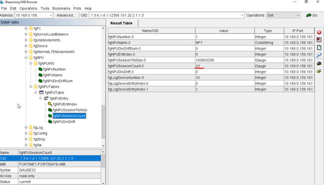

The NPU polling results on the SNMP monitoring tools:
