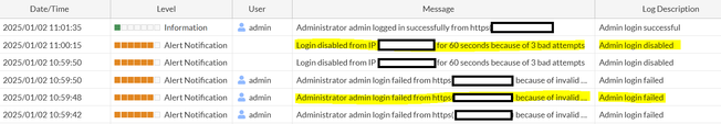

  1. On the FortiGate, check Event Logs for Authentication Failures under Log & Report -> Events -> User Events to see authentication-related logs. Look for repeated failed login attempts from the same IP address or user account. Login attempts are at unusually high frequencies.
Example log entries indicating brute force:
"Administrator admin login failed from https(192.168.100.20) because of invalid password/username"
"Too many failed login attempts, user admin is locked out."
"Login disabled from IP 172.25.181.177 for 60 seconds because of 3 bad attempts"

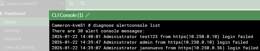

  1. Run the command 'diagnose alertconsole list', the command displays the source ip where the attempt originated.
