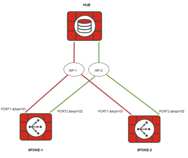

Consider a typical network where 2 spokes have 2 uplinks to the Hub.

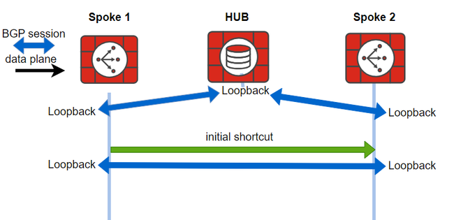

Once the first shortcut is established, the BGP session will run between both loopback addresses over this shortcut as shown below:

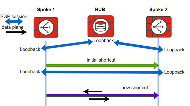

Should this shortcut come out of SLA, a new shortcut will be established, bypassing the out-of-SLA link.
User traffic will move over this new shortcut, but the dynamic BGP session will stay on the initial shortcut.
Should the link stay out of SLA for a time greater than the shortcut idle expire timer, the initial shortcut will be flushed and the dynamic BGP session will move to the new shortcut.
