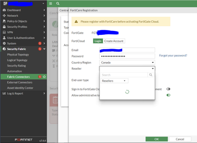

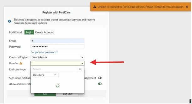

This article describes the case when trying to register to FortiGate to FortiCare through FortiGate GUI, the user needs to select the correct reseller from the dropdown menu. However, sometimes this option keeps on spinning and does not show the correct options at all.

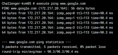

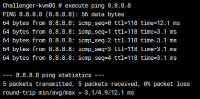

One of the main reasons for this issue is internet connectivity. Make sure that FortiGate can reach the internet by pinging using the IP address.

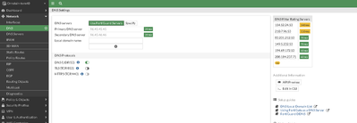

It is also important that FortiGate should be able to resolve the hostnames using the system DNS configured on the FortiGate.

If the 'Reseller keeps spinning' issue occurs on a brand-new FortiGate during the initial configuration—where the device is unable to proceed to full GUI or CLI access (see attached screenshot) before completing the reseller field—console access is needed to manage the device.
Through the console, internet connectivity should be verified. If required, the interface intended for internet access (for example, port1) can be manually configured using the upstream ISP router in mode: DHCP if needed.

Ensure that the DNS servers used on FortiGate support the correct protocol (cleartext or DoT or DoH) as per the following KB article: Technical Tip: Changing the DNS protocol used by FortiGate to initiate DNS requests.
In the GUI:

The wrong DNS protocol configuration will result in unresolved hostnames and FortiGate cannot reach the internet using hostnames/URLs.
Another scenario is if the FortiGate can resolve and reach the hostnames/URL but the Reseller option is still not loading.
Disabling FortiGuard anycast and using another protocol and port will load and populate the Reseller option.
