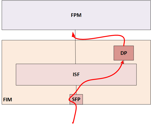

On chassis-based FortiGate, a packet eligible for load-balancing goes through to the FPM in this order:
The packet goes straight to the FPM when the corresponding traffic pattern is caught by a flow rule.
This behavior could be useful during a troubleshooting session when a load balancing problem is suspected. Once the flow rule matches the problematic traffic, the chassis will act as a regular FortiGate. It means that no more load-balancing features will be involved.
