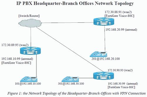

This technical tip provides an example of how to deploy an IP PBX system between the Branch Offices and the Headquarters Office with VPN connection in a corporate network.
In this example, the "ABC" company has a Headquarters Office (Site_A) at Sunnyvale in the United States, a Branch Office (Site_B) at Beijing in China, and a Branch Office (Site_C) at San Jose in United States. When business is growing up, the telephone usage is getting heavier between the Branch Offices and the Headquarters Office. It is ideal solution for providing low cost communications between Branch Offices and Headquarter Office. "ABC" chooses FortiGate Voice-80C IP PBX to deploy IP telephony between the Branch Offices and the Headquarters Office. Through the VPN Connection, the FortiGate Voice-80C at the Branch offices can be connected to the FortiGate Voice-80C at the Headquarters office. Every employee can be reached via a 3-digit extension by a simple dialing plan configuration.
The FortiGate Voice-80C is a multi-function, multi-threat security platform that connects and protects remote and branch offices. It combines the functionality of a multi-threat UTM security gateway, VoIP gateway, IP PBX, VPN with strong encryption, router and switch into a single, integrated device.
FortiGate Voice-80C meets the needs of small, medium, or branch offices to do more without spending more. It delivers integrated data security, VoIP support, and a full-featured PBX, all managed by a single console. The IP PBX features include voicemail, message notification and unified messaging with interactive voice response (IVR). It provides support for SIP Trunking (Class 5 PSTN bypass) and supports standard SIP terminals, including hard- and softphones and SIP applications.
The setup is as follows:
Headquarter Office (Site_A) FortiGate Voice-80C (internal:192.168.10.99, wan2: 172.30.89.95).
Branch Office (Site_B) FortiGate Voice-80C (internal:192.168.20.99, wan2: 172.30.88.91).
Branch Office (Site_C) FortiGate Voice-80C (internal:192.168.30.99, wan2: 172.30.90.93).
FortiGate Voice-80C Devices, SIP Phones, Network Switch and Router

Testing Results
SIP Phone extension 101 registered to Headquarter Office (Site_A) IP PBX with local connection (192.168.10.0/24).
SIP Phone extension 201 registered to Branch Office (Site_B) IP PBX with local connection (192.168.20.0/24).
SIP Phone extension 301 registered to Branch Office (Site_C) IP PBX with local connection (192.168.30.0/24).
SIP Phone extension 301 was able to make call to SIP Phone extension 101 with the VPN connection.
SIP Phone extension 301 was able to make call to SIP Phone extension 201 with the VPN connection.
SIP Phone extension 101 was able to make call to SIP Phone extension 201 with the VPN connection.
SIP Phone extension 101 was able to make call to SIP Phone extension 301 with the VPN connection.
SIP Phone extension 201 was able to make call to SIP Phone extension 101 with the VPN connection.
SIP Phone extension 201 was able to make call to SIP Phone extension 301 with the VPN connection.
Any one SIP Phone was able to make call to any other one SIP Phone and was able to talk each other by using VPN connection (Hub-and Spoke Configuration).
