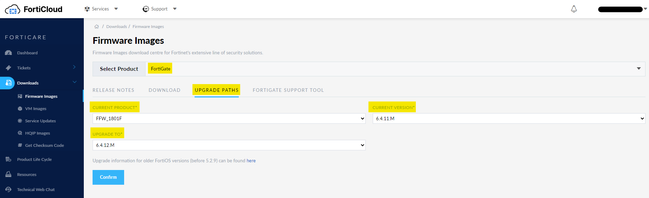

Option 1. Verify the upgrade path by following these steps:
  1. Log in to the support portal (support.fortinet.com).
  2. Go to Support -> Firmware Download
  1. Select Product: FortiGate -> Upgrade Path.
  1. Select the product model (Current Product).
  2.  Select the current device firmware version and upgrade to the firmware version details.

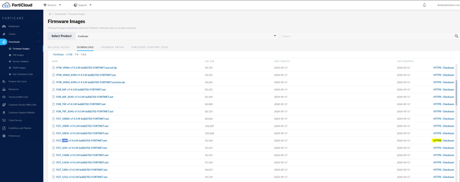

To download the image files, navigate to the support portal, go to: support.fortinet.com -> Support -> Firmware Download,
Select Product: FortiGate, and 'Download'.
Navigate to the required firmware version, locate the image file, and select HTTPS as in the example below. Note that 'pop-ups' must be allowed on the web browser for the HTTPS button to work.
Example: FortiGate 100F.
File name starts with -> FGT_100F.
Select 'HTTPS' to start the download.

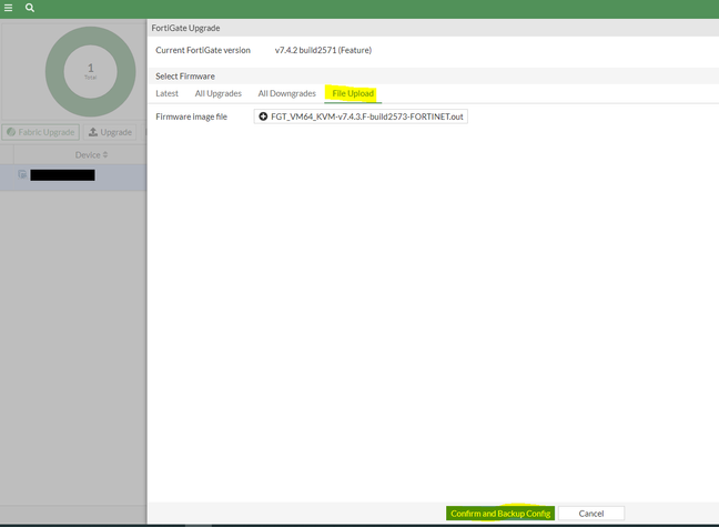

Upgrade the firmware from GUI v7.0.x, v7.2.x, and v7.4.x:
  1. Log in to the FortiGate GUI as the administrative user.
  2. Go to System -> Fabric Management (v7.0.x/v7.2.x) or Firmware & Registration (v7.4.x).
  3. Choose the FortiGate, select Upgrade, select File Upload, select Browse, and locate the previously downloaded firmware image file.
  4. Select 'Confirm and Backup Config'.

  • Check the screenshots below showing the upgrade procedure in v7.4.x.
  • Go to System -> Firmware & Registration.
  • Select the Device and select Upgrade.
  • Select the file upload option and add the appropriate firmware image downloaded from the Support portal.
